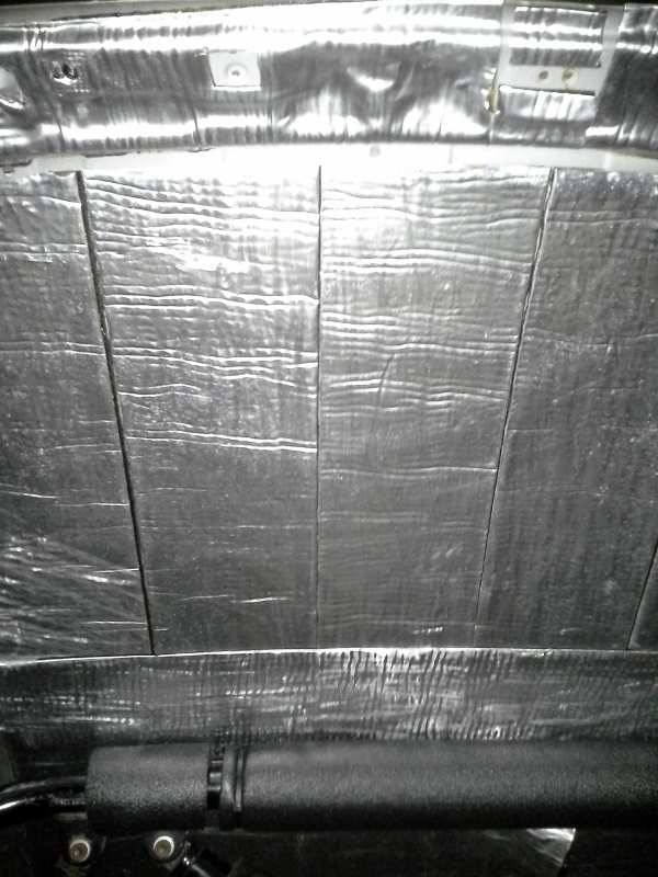

Eugene noticed the car was dynomatted. We didn't know to what extent until I got home and inspected it. This had to have been an audio competition car previously. There is hundreds of dollars and 30-50lbs of the stuff. So thorough they removed the dash to cover the firewall.
Even wasted their time covering the a pillars!

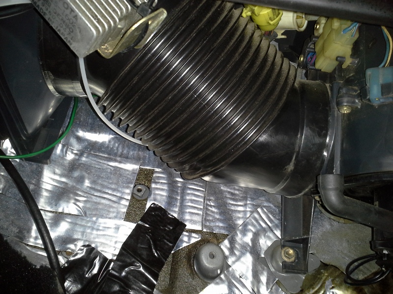

I was told the car had no heater core or AC, but was pleasantly surprised to find the blower and ventilation all works. This piece doesn't seem factory but fits so well.

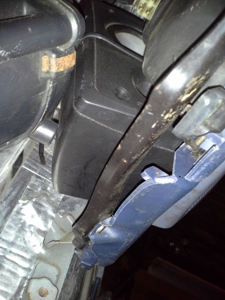

There's no radio but there is a Creative Labs pc speaker here for the passenger.

dammit. so much money spent on dynamat, but skimped on the motor and electrical. that piece between the blower motor and the big hvac vent is an a/c delete pipe. actually rather sought after. wish i knew more about 4agze
Re: Corolla discovery thread
Posted: Thu Feb 28, 2013 9:08 am
by Greg
revel wrote: that piece between the blower motor and the big hvac vent is an a/c delete pipe. actually rather sought after. wish i knew more about 4agze
Same on the miata, seen them go for $100 before. I have one.
