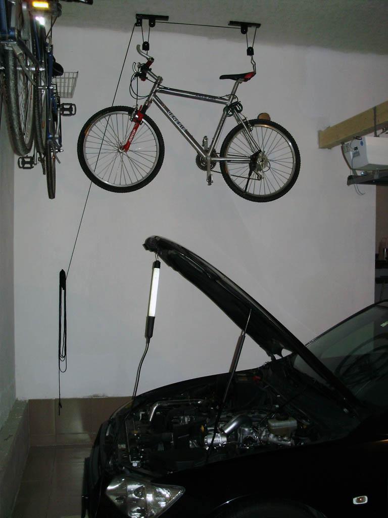

pics:
for the people that can't get enough of my naked engine bay :D
